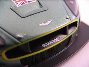

Okay, here's what I got...
The upgrades are slim, but it's a start.  It has bearings, aluminum wheel nuts, an FRP T-Plate, and an Atomic Stock Motor.  There are also a few spare parts in a bag like a motor pod, pinions, and some used tires.  A few tools too...
I also picked this up for it:
It all seems to work.  Let the upgrades begin!
