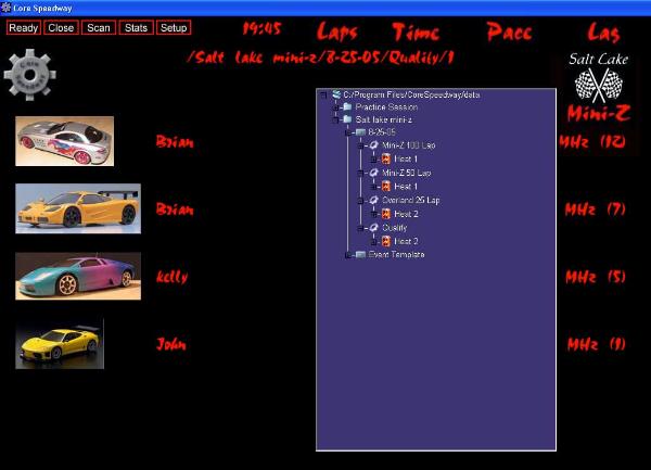

Starup Screen with Racers Added |

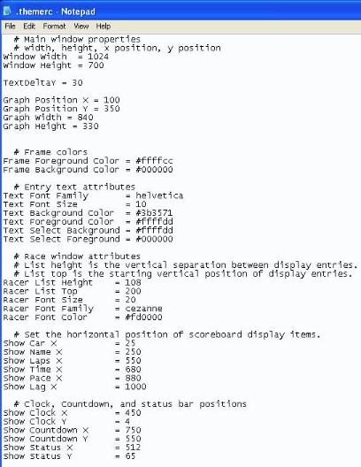

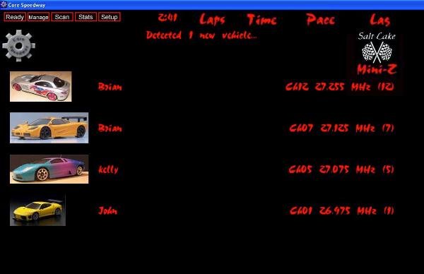

Install the transponder in the car under the hood, as close to the front as possible. (we used a small piece of velcro) Install Software and Hardware as per provided install manual. Connect hardware to Computer with provide USB cable (and the extension is you have one). Start the Corespeedway Software. That's it. Don't forget the Manual it's in the install directory called Core_manual.pdf (this will help you a lot). At first the software was a little confusing, but once you get use to how it is laid out it's really very simple. See pictures to the right for reference. First of all the software is very customizable. What you see in our screen shots is our customized theme. You are able to change just about everything. Themes can be changed on the fly by setting the themes in the setup screen. You will need to copy the default theme folder and rename the new folder. Font styles and colors are changed in the .themerc file in the theme folder. To change the Graphics you will need some photoshop skills. You are able to add you custom logos and text by making changes to the big_frame.jpg file. I am using a widescreen laptop and these are the settings that I needed to make for all the Racers and Graphs to show correctly. |

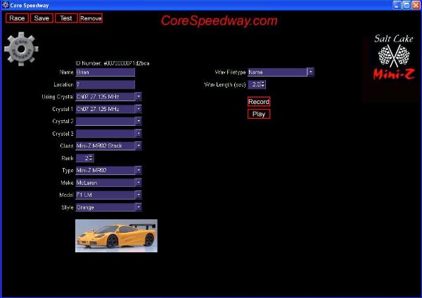

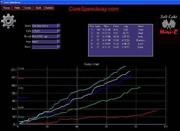

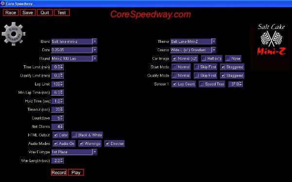

That is how we achieved our Salt Lake Mini-Z custom theme. Using the system is really easy. Start up the software, set a car with a transponder in the loop and hit scan. The software will read the transponder. Double click on the default car picture and you are ready to set up the car. You will need to complete all fields in order to save the information to the transponder. For Custom car pictures you will need to have you picture in the corresponding directory under C:\Program Files\CoreSpeedway\lib\cars in the following format: Manufacture-model-color.jpg (200 x 80) and Manufacture-model-color-x1.jpg (100 x 40 for the half size picture) You can customize a little more here with some sound clips for that individual racer. You have three different clips. (Name, Best Lap, Takes the Lead). You can be really creative with this one. Enter all Racers in this manner. Setting up your Race. You have 2 options. Timed or Total Laps. One thing to remember is to set your minimum lap time so it is below what the best possible time for the track you are running on. Results won't be saved until you complete the race criteria. So if you stop in the middle no data will be saved. Now you are ready to race. Everyone lines up in their starting positions, you will hit the space bar to start the race. The software will count down from 10 (depending on what you set it to 1-10) and a horn will sound to start. You will hear a beep when the cars cross the antenna loop so you know that the car registered the lap. Note: if you have some sound clips and they play you will not hear the beep when a car passes the loop, they will continue after the sound clip. Around and around you go, catch me if you can. When the time limit or lap limit is met you will hear a "car done beep" and the remaining cars will need to finish their current lap. You can then view the stats for the current race. There are a couple of different graphs and charts that you can view. Race stats screen, Racer stats screen, and the web stats screen. (see pictures for samples) Everything seemed to have its place, there wasn't a lot of useless extra features thrown in. Just a no nonsense timing package. It does exactly what it was designed to do Count Laps, keep times and gives you the information you need to help improve your racing performance. Is it worth purchasing? In this users opinion. Absolutely Is it affordable? I pre-ordered from Corespeedway (so it was for me). I'll hold off my judgement until I see published prices from Kyosho. Ease of use? All things considered, Yes. For those that are computer illiterate, just stick to the default settings. It won't be long until you learn the software. It's that easy. There are LOTS more features than what I reviewed. You will have to get the system to learn about them, if you have already purchased it, then I hope this helps. Brian Stanley 8-28-2005 Salt Lake Mini-Z |

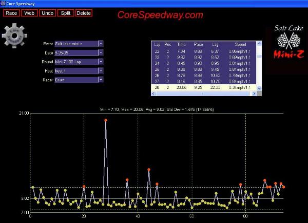

Race Stats Screen |
Racer Stats Screen |
Web Stats Screen |
